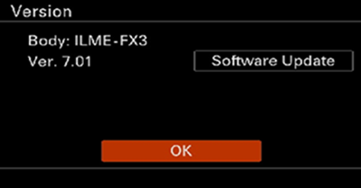

Check the System Software Version
Follow the instructions below to check the system software version:
    1. Select MenuSetupSetup OptionVersionBody.
    2. The system software version will be displayed.

    2. Select MenuSetupSetup OptionVersionBody.
    3. Select Software Update.

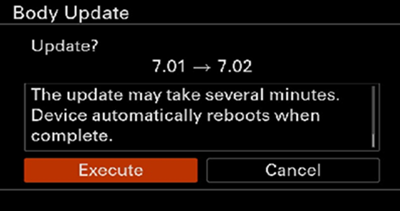

    4. Select Execute on the system software update confirmation screen. The software version update will start.
      On-screen message:
      • Update? X.XX → Y.YY
        • X.XX: Current version number
        • Y.YY: Newest version number

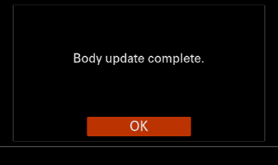

    6. When the update is complete, the camera will automatically restart. After restarting, press OK on the “Body update complete” screen.

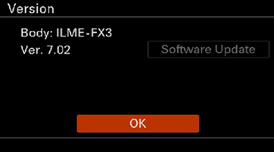

    Step 2: Confirm the System Software Version of Your Camera
      The update was successful if the screen shows Ver. 7.02.
